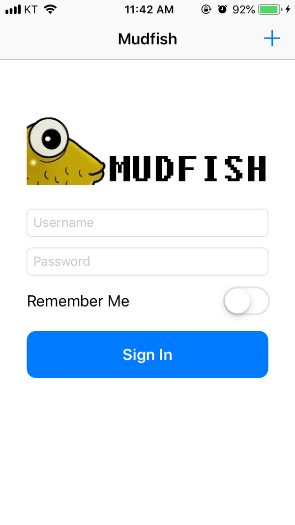

Front screent is the sign-in scrrent. By clicking (Plus) icon, you can sign up.
If you want to keep the sign-in alive, you can use "Remember Me" button.

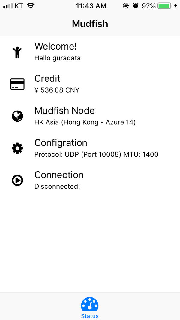

Very simple screen with the following options:
  • Welcome!

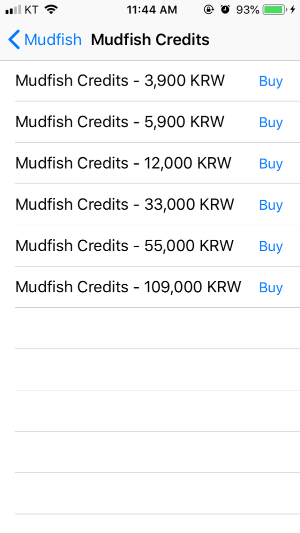

  • Credits
    Show the current mudfish credit balance. If you click it, it moves to the screen for InApp payments.

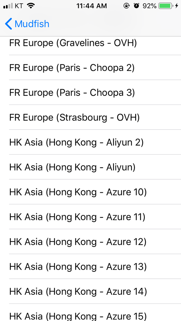

  • Mudfish Node
    Show current mudfish node you picked. If you want to change, you can touch.

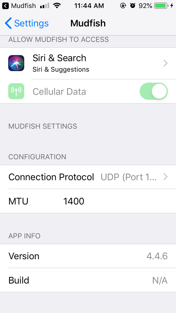

  • Configuration
    You can change Connection Protocol and MTU.

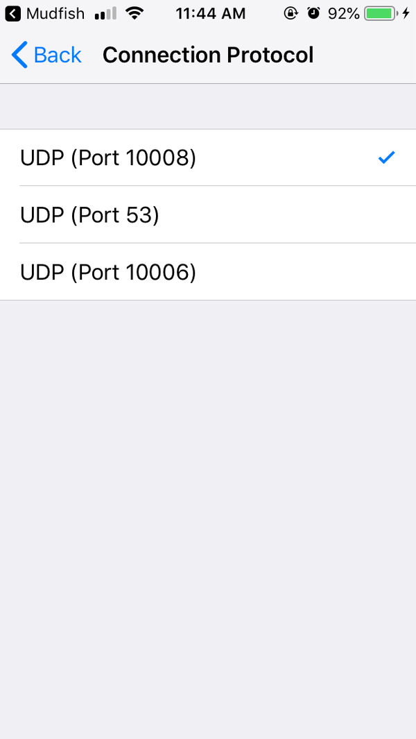

    • Connection Protocol
      Currently only UDP protocol is supported. As default, it's UDP (Port 10008)
    • MTU
      You can specify MTU size. As default, it's 1400 bytes.

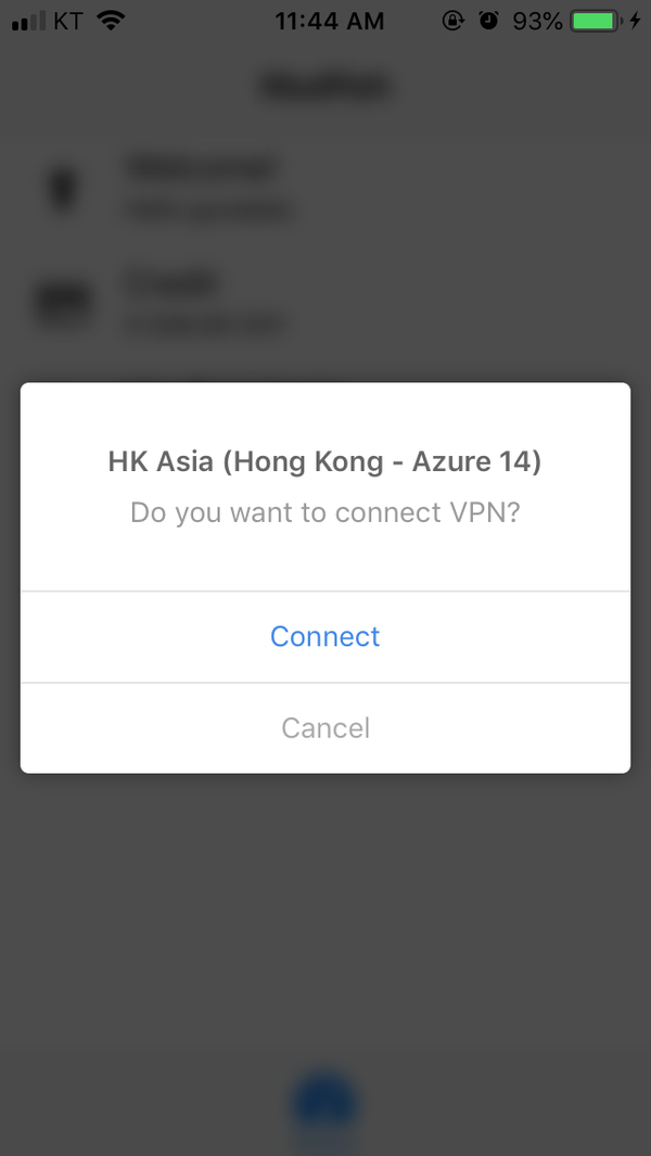

  • Connect
    Points current connection status. If you click, you can do "Connect" or "Disconnect".
