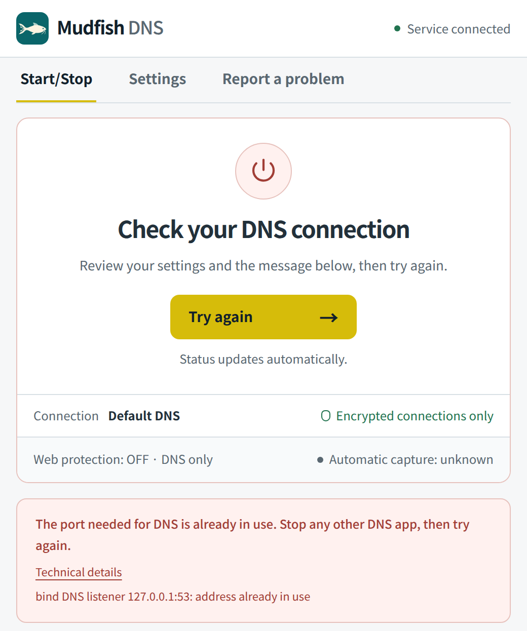

DNS does not start​
Check the message on Start/Stop and expand Technical details.
  • Service is unavailable: On Windows or Linux, check that the installed Mudfish DNS service is running. Opening the window alone does not start a missing or stopped service. On Linux, inspect it with systemctl status mudfish-dns.service.
  • DNS port already in use: Stop another local DNS program, including the old Mudfish DNS Client, before trying again.
  • Permission or capture error: Complete the macOS extension or Android VPN approval. On Linux, check the eBPF requirements if you enabled automatic capture, web protection, or app/domain selection.
  • No DNS servers available: Check your network, keep a server enabled, and inspect its address, transport, certificate hostname, and connection status. If you configured a SOCKS5 proxy, check that it is reachable too.

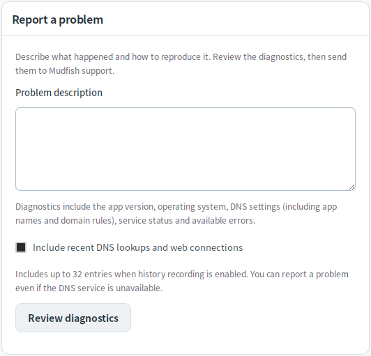

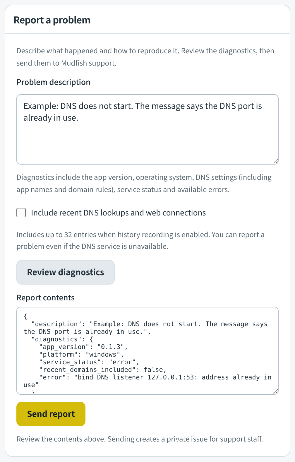

Report a problem​
  1. Open Report a problem and describe what happened and how to reproduce it.
  2. Select Include recent DNS lookups and web connections only if you want to attach recorded history. It includes up to 32 existing entries and does not turn recording on.
  3. Select Review diagnostics and check the report contents.
  4. Select Send report. Keep the reference number for follow-up with Mudfish support.

Diagnostics include the app version, operating system, DNS settings (including server addresses, app names, and domain rules), service status, and available errors. On Windows, available recent service error logs are also included. The report creates a private support issue. You can prepare a report even if the DNS service is unavailable.
