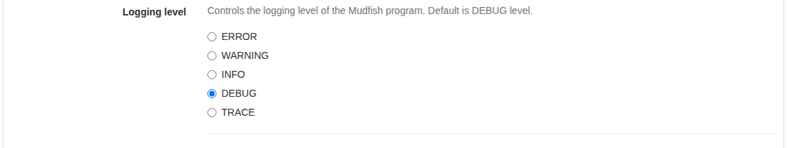

  1. First you need to increase the debugging message level to "TRACE". This option will make Mudfish being more verbose.
    This option is found under "Setup -> Program -> Launcher" menu.
    info
    Please note that this option is only available Mudfish Cloud VPN v5.7.4 or above.
