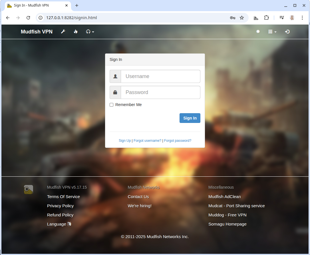

  2. Run Mudfish Launcher with administrator privileges (or root privileges on Linux/macOS), then sign in.
    picture 0

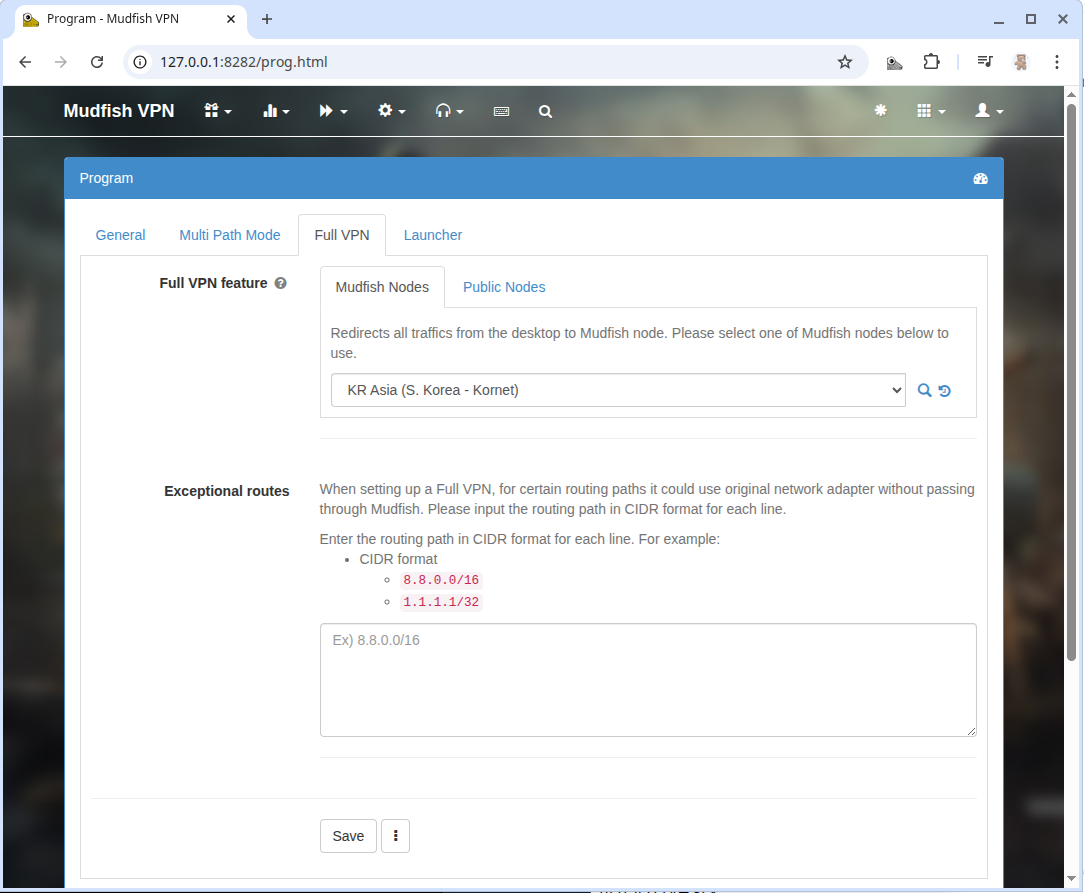

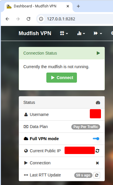

  3. Enable Full VPN mode. You can pick any mudfish node if the game is accessible with it. Then restart Mudfish to apply.
    (You must turn on Full VPN mode to detour game traffics with Mudfish.)

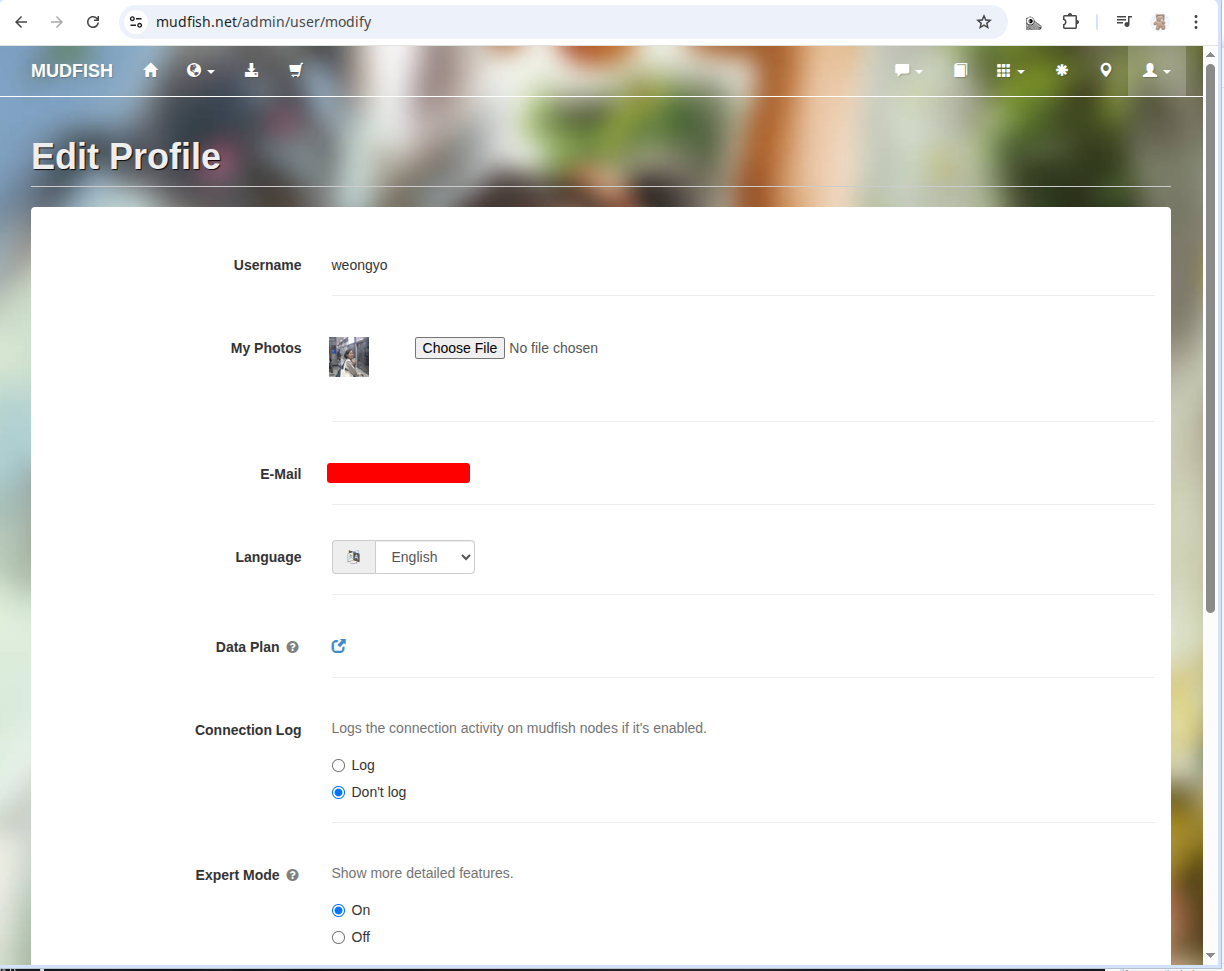

  4. Enables Expert Mode to show more advanced options.
    picture 3

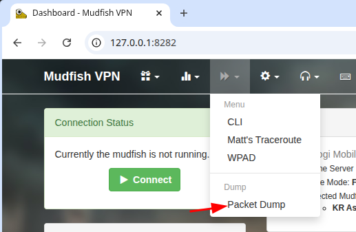

  6. Move to 'Advanced → Packet Dump'
    picture 4

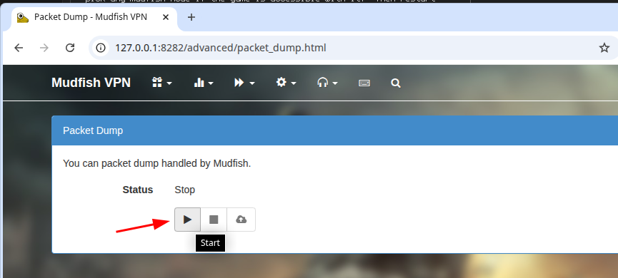

  7. Click the Start (triangle) button to begin the packet dump.
    picture 5

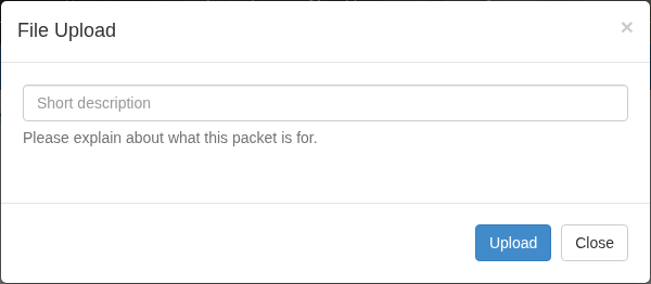

  10. Click the Upload (cloud) button, then send it with a short description of what this packet dump is for.
  1. If it'd uploaded correctly, you can find it at Mudfish Forums as privacy mode enabled. If it's not found, it should be a bug so please contact us.
