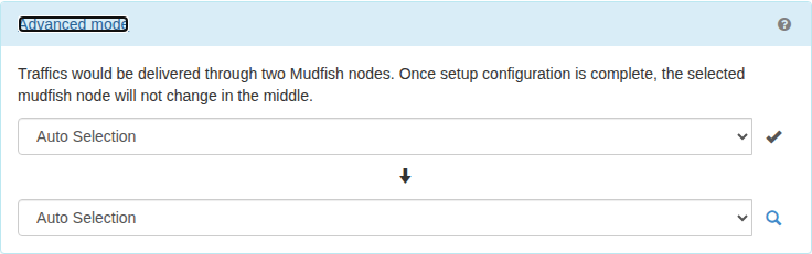

Should I use advanced mode and set one node near here and the other on game server?​
My preference is 'Basic Mode' first. If you can't see any beneficial by using the basic mode, you can try to use 'Advanced Mode'.
What is the advantage of connecting to the game through two Mudfish nodes over one?​
Please note that you don't use two mudfish nodes (advanced mode) if your connection is enough stable and okay to access to the game server. Definitely there's pros and cons for advanced mode than basic mode
  • Pros
    • If you can't detour the network congestion with one mudfish node (basic mode), you can use two mudfish nodes.
    • If your game has a region restriction and you can't find a proper node to access with one mudfish node, you can use two mudfish nodes
  • Cons
    • Using two nodes increases instability of connections. Specially for RTT stddev could be more bigger though it depends on the status of mudfish node.

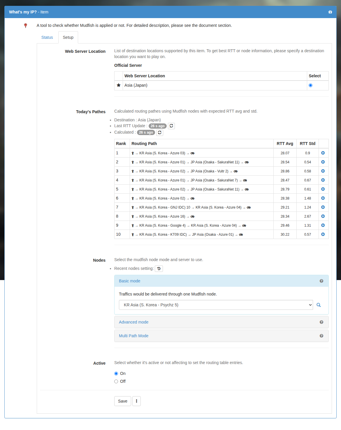

  • Click the game item to enter the configuration menu at Dashboard.

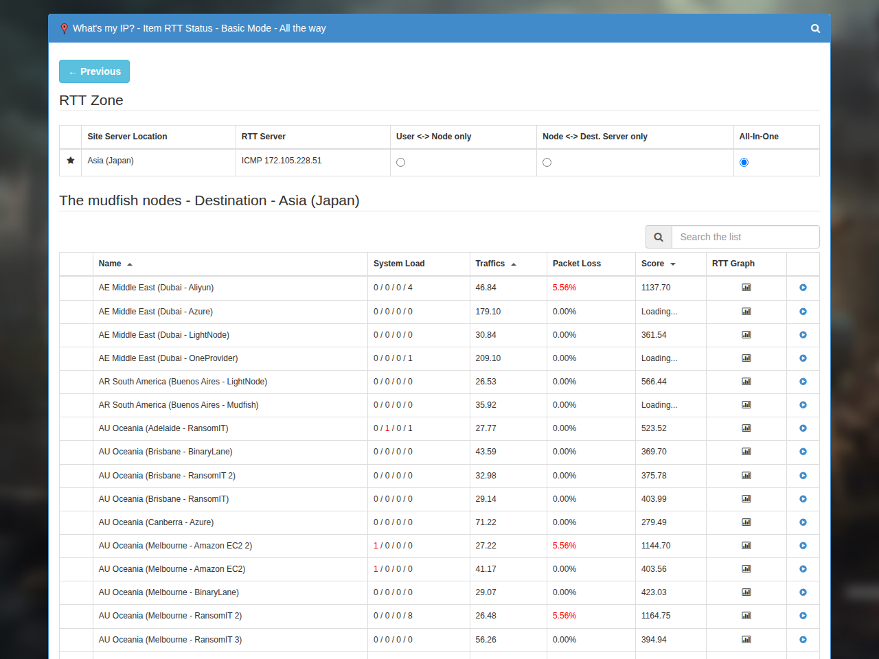

  • At 'Setup' tab, you can find 'Nodes' option. At there click the magnifier icon, it'll pop up a window.
  • At pop-up window, you can click a game server location you enjoyed to play. Depending on your game location, it shows more details information from each mudfish nodes. For example,
    • Server Location
    • System Load
    • Traffic for last 5 minutes
    • Score
    • RTT Graph.
  • To pick the mudfish node, the following are priorities to be considered.
    1. Lower score is better.
    2. If multiple nodes have similar score values, please see RTT graph. If the graph is around flat (points that RTT std is closer to 0), it'd better.
    3. Traffic for last 5 minutes could be considered. But depending on the mudfish node's capacity, it could be okay or not.

Please visit the following site to see shortest paths calculated based on your recent RTT information.
How do I get the updated routing paths?​
Unfortunately at this moment it's no way to update it manually. It's one of tasks I should fix. However these update event is triggered:
  • When you sign in using Mudfish Launcher.
  • When you changed the option of game item.
  • When you changed the configuration of Mudfish.
  • When you changed Full VPN mode option.
But please note that these update processing should be delayed depending on how RTT calculation server is under load.
What does System Load mean?​
These values means "CPU Steal % / IO Wait % / No. of Network Card Error / Congestion Score ".
  • CPU Steal %
    This points that how many CPU % is stealed by Host OS if the mudfish node is on virtual environment. So if it's high, it means it's under more heavy load.
  • IO Wait %
    If this value is high, this points that there's many disk related operations on this mudfish node.
  • No. of Network Card Error
    It shows how many network errors happens on NIC of mudfish node.
  • Congestion Score
    This number points how many connections or sessions from the mudfish users are established (created).
    For example, if this value points 50, it means there are 50 connections between mudfish node and users.
    So the lower number is better if possible.

Most important thing is RTT stddev between mudfish nodes and the game server. This information is available when you click "the magnifier icon" found at the item configuration after enabling Expert Mode.
